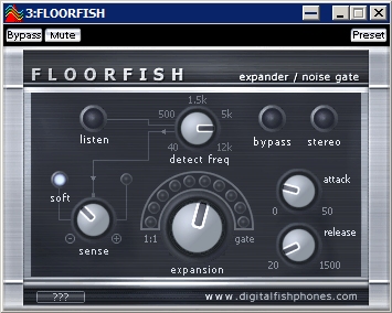

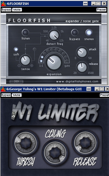

You'll need a Sound Editor that supports VST plugins
1)Add compression to the audio with a VST compressor
http://www.betabugsaudio.com/dl.php?id=9
2) Add and apply expansion to the compressed signal
http://www.kvraudio.com/get/860.html
That's pretty much how Dolby labs used to do it for their tape hiss reduction.
Here's an example clip of a hissy source:
orig1.mp3

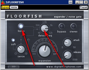

1) Using the Floorfish plugin, choose the "listen" button along with "detect freq" to find the hiss frequencies.
Here's the sound of the hiss dialed in, somewhere around the 8Khz mark
hissonly.mp3
2) Once you've found the hiss frequency, unclick the listen button and dial in the amount of expansion you desire. Don't go too far, as you'll make it sound artificial. Here are the settings I used on this recording:
And here is the hiss-reduced result:
dehissed.mp3 -

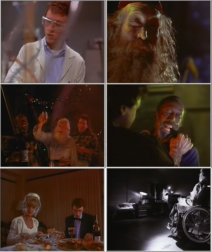

Here I attach a couple of screen captures (I'll upload video , and audio samples ASAP)
What do you see in those caps? how could I improve it?

I can't see much problem with that. Maybe some chroma problem, but it's not terrible at all. It could probably be fixed with aWarpSharp in AviSynth. And perhaps the image is a little dark. If that bothers you, download the latest 'gradation curves' VirtualDub plugin, and try to play around the levels in "RGB weighted" mode. Use very slight adjustments on the curve. It'll improve the noise too, but many times it still worth it. -
Hi again, well, Like I said, that was te good source. The other one was beyond hope.
Thats the actual size of the image. res is 352x280 1262kbps. I'm not sure about the VHSRip standards but that seems a bit low wouldn't you think?
I think you can't see it from the screens but one of the things I wouldlike to filter is that "soft" texture around objects or people... I would like to increase definition (I'm trying to encode to DVD here) maybe I'm just too used to standard DVDrips and I've already forgot how a VHS tape looks like
I dunno...
Maybe when I upload the videos you'll see some other things.
I'm not sure about what I'm looking for exactly... I'm trying to get all the info I can from people who know much more than me (starting by the fact that I know nothing xD)

Mind you, I think the color is not chroma error, the original looked like that, I think its on purpose. (Im not sure though. Please you be the judges xD) -
Yeah, 352x280 is a bit low. It's about VCD level. I would've captured it in higher resolution.
I can't see that soft texture around objects (at the office my screen is quite shitty), it's probably related to some sort of edge enhancement. Probably I should've written edge-related problem instead of chroma problem. aWarpsharp() is a way to go. Perhaps Didée's simple YAHR() script, or some other dehaloer will help, but it's not easy to fix that.

The video is easy to fix too, just needs some color filters. The relative sharpness can be increase with filters too, and I'd upsize it to 352x576 (352x480), leave PAL and PAL, or NTSC as NTSC. The video is damaged enough already, let's not make it worse. What I see is too much orange, and oversaturation. It's mild, this is quite decent starting source.
