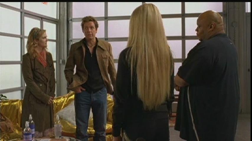

First lets try to define the goal. A 1366x768 LCD TV is square pixel 16:9 or 1.78 to 1 native.

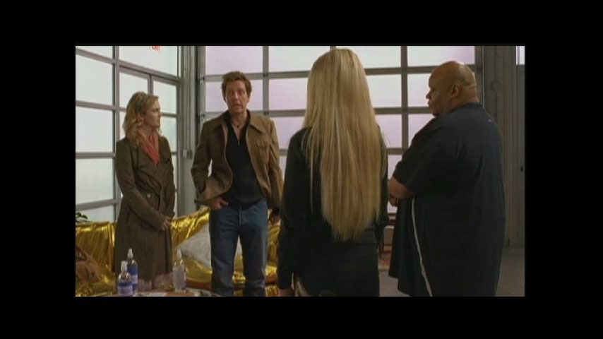

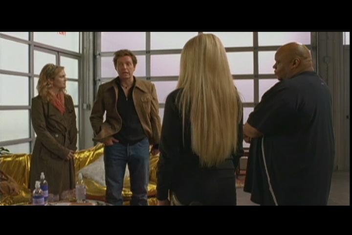

A 1.85 to 1 aspect movie should show as mild letterbox and a Cinemascope or Panavision 2.35 to 1 aspect should show with considerable letterbox as shown in this graphic.

Is this the problem? This is a 4:3 letterbox 2.35 to 1 movie displayed on a wide TV in square pixels. You get letterbox plus side pillars. Many HDTV sets have a zoom mode to address this common issue.

I think we need a reference on this discussion. Play a 2.35:1 movie on your DVD player and tell us or show us what you see. It should look like the 2.35:1 in a 16:9 frame example above.

The 2.35:1 does look proper with black bars top and bottom as far as that goes.

This is a 1.85:1 aspect example at 720x480.
and would fill a 1366x768 square pixels display like this with just small letterbox that for 1.85:1 is usually lost to overscan..
Where typical letterbox 1.85:1 aspect inside a 720x480 capture would look a bit wide.
and would display this way on a 4:3 screen
and this way at 1366x768 unless zoomed at the TV.
The lower three pictures are typical output from a cable box or DVD recorder.
2.35:1 aspect would look similar but with wider letterbox stripes. -
