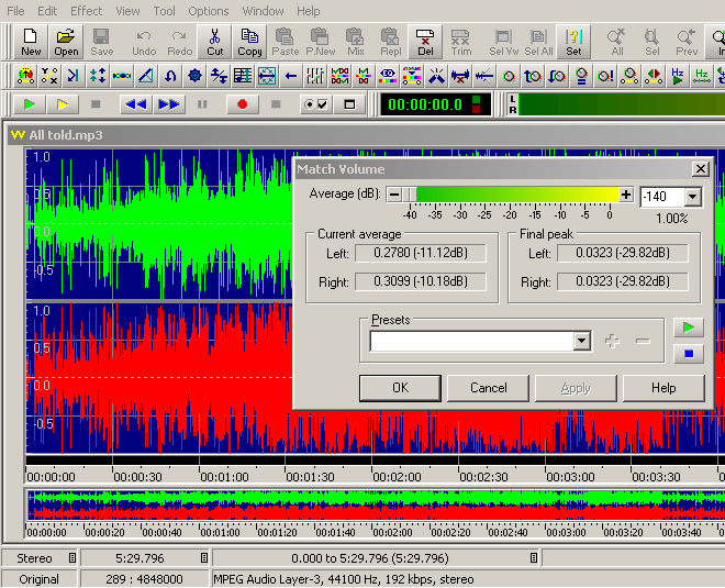

    Not sure GoldWave will do it for average volume (simple editors only do it for max peak value), but in Adobe Audition (formerly CoolEdit Pro) you can select the type of normalization (peak or average normalized value).
    Here's detailed description:
    http://kb.adobe.com/selfservice/viewContent.do?externalId=329226&sliceId=2

    In Goldwave it's called Match Volume. It can be set to the level you want (I use -14db usually) and can be used during Batch Processing.

    racer-x, you've saved my life... it's a shame I didn't think of it, although I always used GoldWave for sound editing. Thanks again!
