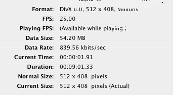

Here is an example of the Movie info using QT

In the Video tab, I made the width and height equal to the original video (let's use 512 x 408 as in your example). Then I clicked on the Filters tab and set the letterbox to fill up the width and height in order to reach 640x480 (the standard for NTSC TV). In your example, I'd set the top and bottom to 36 each (36+36+408=480), and the left and right to 64 each (64+64+512=640 - which, when made into a DVD, becomes 720).
My "test" video was 640x352 so I set the video size to 720 x 352 and used 64 pixels for the top and bottom letterboxing (in the "Filters" tab).
