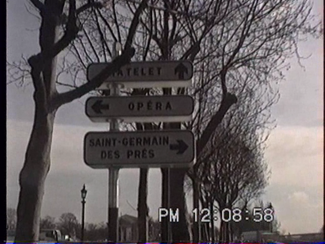

I have purchased a used Sony TRV460 to convert my old Hi8 video tapes. I purchased it because I thought analog to digital conversion would be best from a camcorder. However, I've noticed that there is a horizontal line near the bottom. I've attached a frame that illustrates this annoyance. Video and audio is fine but I'm irritated with this line. Is there anyway to remove it?

That is most likely the head switch. This usually displays off screen in the overscan area so is not noticed on a TV. What you see in that picture is much less than for normal Hi8.

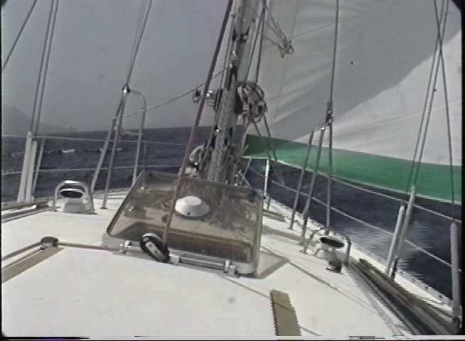

This is more typical. The corner crops in this picture are due to a lens splash filter.

Thanks. So if the horizontal line is an artifact due to the scanning head which seems to be present in all tape-type camcorders (at least Sony), is there a way that the output video can be cropped? I plan to digitalize the Hi8 videos and they play them back on my computer.
Well, what you can do is zoom in a tiny amount 'till it's gone...
Yes, it's more safe to hide it (avoid resizing interlaced video vertically). AviSynth:
Letterbox(0,8) -
