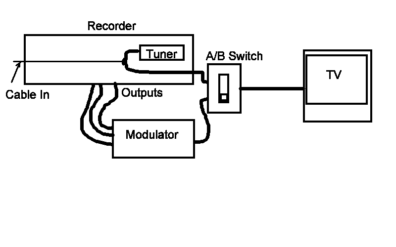

How about...
Continue to use your RF modulator to view the output of the recorder but add in a A/B co-ax switch. Connect one input "A" of the switch to the output of the modulator, connect "B" to the pass-through RF jack on the back of the DVD recorder and connect the oput of the switch to the TV. You can switch back and forth between the recorder output and cable broadcasts. -
Not quite sure I follow where this would connect...
If I have it all set up and want to watch just tv, i would have it switched to A...if I wanted to record, would I have to switch it to B? and if i was recording, would I be able to watch another channel...
Or, would I only have to switch it to B to watch the DVD recorder, but be able to record while on A... -
You can record in either A or B position of the coax switch. If you want to watch something else on broacast cable while recording, put switch in position B. You must put the switch in position A to watch something off of the recorder.
The key point is that there is a splitter inside the recorder. The signal is routed to the internal tuner of the recorder and (merely as a convenience) to the RF out jack. Recorders differ from VCRs in that there is no RF modulator built-in. If you keep the above in mind and look at the picture, all should become clear.
switch.bmp -
Thanks for the help, all! I replaced my RF with a different switcher and now all is well. I appreciate the info on how this stuff works. thanks.
