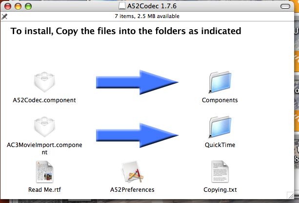

    The A52Codec should give all applications that utilize QuickTime the capability to decode this audio.
    May 2004
    There is a prefs that has to be set for that component. If you download the updated codec and mount the dmg, drag the two items on the left into their respective folder shortcuts and then set the prefs.

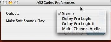

    May 2004
    This is the drop down of choices for output
