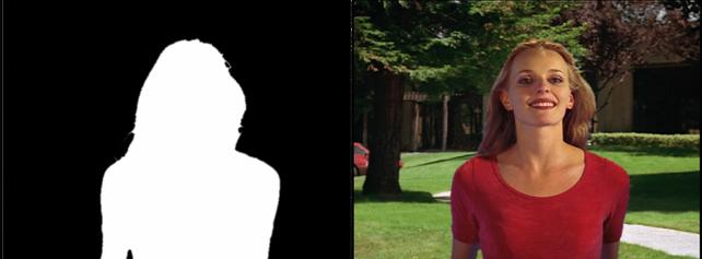

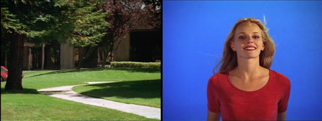

    You shoot the person in front of a green background then use the software to "key out" the green leaving the person and an "alpha" defining the persons edges.
    Then the new backround is added in the areas not defined by the "alpha".
    Picture 1: desired background
    Picture 2: person in front of chroma key background
    Picture 3: the resulting "alpha"
    Picture 4: the composite
    Background shows where alpha is black.
    http://www.cescg.org/CESCG-2000/GBlasko/index.html
