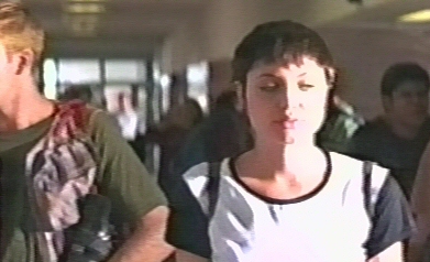

Here is a cropped screenshot from the clip.

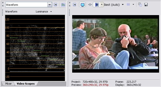

Not much left to work with there. The heavy contrast pushed the face detail into the 107-108 IRE range. The iris was open too far. It lifted black level and white.
These two can be improved (right half) by adjusting black and white level.

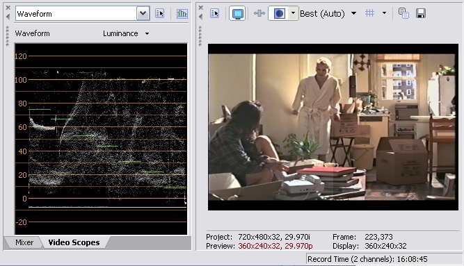

I was just adjusting white and black to 16-235 per the Vegas scope.
A good clue to where black should be per original recording (precapture) is the bit of blanking usually captured at the left and right edges. For NTSC this should be placed at negative 7.5% (~digital zero) as a first approximation. Your capture device seems to be clipping at 100IRE so I placed the clipped area at level 235.
If this were a PAL capture, blanking would be placed at level 16. -

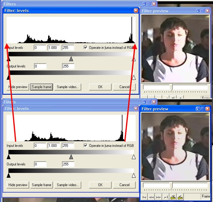

VirtualDub filters won't work if the bright areas are above IRE 100. VirtualDub filters work in the RGB colorspace where everything above IRE 100 becomes the same shade of white (R=G=B=255) so any detail in that area will be lost before the filters can adjust them. You need an application which can work in the YUV colorspace -- like AVISynth.Originally Posted by grannyGeek
Or you could use AVISynth to convert to RGB without performing the usual luminance stretch, ConvertToRGB(matrix="PC.601"), then do the levels adjustments in VirtualDub.

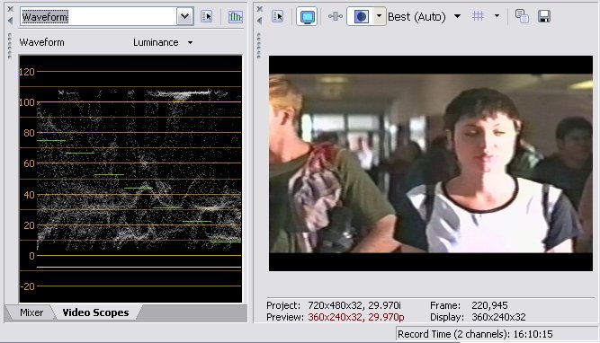

Looking at HiLites_huffyuv.avi though, the problem occured in your VCR, not the capture. That is, the bright areas are not above IRE 100 but are all stuck at IRE 100 (edDV's levels diagrams were made from your JPG files which have already been contrast stretched). You might try capturing from a different VCR.
Here's an example of a video which has sections above IRE 100:
The top half shows the file opened directly in VirtualDubMod. You can see that all detail in overexposed part of the dog's tail is washed out. The bottom half is the same video opened via AVISynth with ConvertToRGB(matrix="PC.601") to avoid the normal contrast stretch that occurs during YUV to RGB conversion. Note how some details are now visible in the overexposed part of the dog's tail. You could now go on and use the Levels control to correct the black level and gamma for the rest of the picture. The red arrows indicate the contrast stretch that takes place during the normal YUV to RGB conversion. Everthing to the right of the right arrow in the bottom section, that is everything above IRE 100, becomes RGB 255. Hence the big peak at 255. At the other end, the same thing happens to blacks. Everything below IRE 0 becomes RGB 0.
Your video has the peak below IRE 100 so the washout occured before the video capture:
