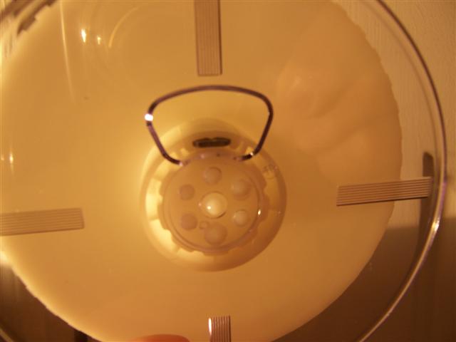

  3. Yes, it looks like the leader pulled out of the spindle. There is a metal clip on the reel that I think held the tape on the reel. I guess this metal clip comes out so I can reinsert the leader back into it?

    If you're talking about where it snapped off right at the spindle, here's what you do (I've done this many times):
    1. Unscrew the 4/5/6 screws from the bottom of the case and put aside.
    2. If the spine of the tape has a label, either slice it lengthwise with a safety razor, or better--get a blow dryer and heat up the glue until you can peel it off like it's butter. Set aside (face up so you can reuse it).
    3. Lift the catch for the hinged door and lift the door up WHILE pullin straight up on the four corners of the top 1/2 of the shell to cleanly open the case. Set aside.
    4. Push back the breaks and lift out the spools (both of them). Unwind a little from the full end to give yourself a little room to manuever (don't worry, the movie doesn't start THAT soon on the tape).
    5. You will see on the empty spool a little fitted plate/patch which holds the tape onto the spool--you now have to get this off...
    6. Get a very small, thin flathead screwdriver and PUSH from the bottom of the spool on the area of the patch--it'll slide out the top of the spool. Set the patch aside and throw away the little tiny piece of tape that was left over when it broke off.
    7. Line up the end of the tape (coming from the full spool) OVER the spot where the patch goes. MAKE SURE it's not turned around or upside-down. ALSO MAKE SURE you leave about 1" of extra tape on the side beyond where the patch goes.
    ***Important part***
    8. Carefully PUSH the patch back onto the area where it is supposed to go WITH YOUR THUMB (otherwise it is sure to flip off your utensil and fly away). PUSH REAL HARD and it will SNAP on.
    9. Replace the reels back into the well, seating so you will engage the breaks correctly.
    10. Replace the cover, putting it directly on top and just laying it down straight and pushing it to. Turn the shell over, holding both sides together.
    11. Screw the screws back in.
    12. If needed, replace the label. DONE!
    This is safer (for your VCR) and sturdier than using splicing tape.
  6. How does that latch on the reel open? Do I need to take out that piece of metal first?
  7. Member Cornucopia's Avatar
    The piece of metal keeps the patch from buckling in on itself (otherwise it's hollow). Some are built that way, others not. IOW, dont' worry about the piece of metal.
    It ought to be able to smoothly slide out when being pushed from underneath the bottom (The Bottom when resting on a table, aka the side with the teeth). If it doesn't, it may be a wierd variant spool (there are a number of makes and varieties of styles from different manufacturers). If nothing works, you can always cannibalize a spool from a blank VHS tape that has a variant that you know will work (FUJIs, MAXELLs and SONYs are good)
  8. Okay got it put back together and was able to transfer the tape. It is tricky to reinsert the tape into that notch. Nothing was lost except for maybe 1-2 seconds at beginning, because I had to cut the leader a little shorter. No big deal.
    At first, I opened up another blank tape and was going to use it's reel, but it was completely different. The parts and the gear notching was different too.
