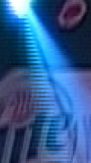

Edit Later: I guess by installing Cedocida it became my decoder. I kind of wish I had back whatever was being used before. Anyway, I took a look inside VDubMod->Video->Compression->Cedocida->Configure, which I should have thought of before. As you suspected, under YV12 Chroma Sampling, it was set for MPEG-2 Non-Interlaced. By changing it to Interlaced, now that frame 173 shows 2 of the encodes with those ugly stripes, the source DV and the Main Concept ones. My CCE and HC encodes are still the same as before. Not sure what that means, if anything. I double-checked that they were really BFF, which I remember doing yesterday before encoding them, and everything checks out. I hope the frame 173 problem doesn't invalidate the other 2 pics I posted of frames 195 and 212.

I hadn't, because I didn't realise progressive sampling would mess up both the encoding as well as the decoding. I've reencoded both my CCE and my HCEnc versions, and now see the pic of frame 173 as in your pic of it, with the yellow stripes in the light, and the blue stripes for most of the way down, for all 4 pics. I've replaced both of my main pics back in my older post, and removed the one without the stripes.Did you reencode them with the corrected Cedocida settings?

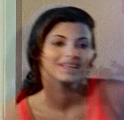

They should have asked me, because I encounter this problem with some frequency. If you work with Indian DVDs, you'll come across virtually everything that can possible be screwed up. I call this one coloring outside the lines, like a first grader and her coloring book. Here's a pic where some of the chroma for one frame comes from the chroma for the previous field:But as soon as something moves, a strange artifact appears. The chroma information from field 1 leaks into field 2 and vice versa on every pair of fields, and the result is a bizarre pre- and post-echo in the chroma channel. On slow movements, it manifests as a smearing of all the chroma information, and on fast movement it looks like people and objects are split into two parts - a high-resolution luma object and a low-resolution chroma object. It's difficult to describe. We were unable to get a screen shot for this article, but trust us when we say it's just as distracting as the chroma bug, if not more so.
She's dipping her right shoulder and moving from left to right, and some of the chroma is where it was in the previous frame, to the left of where it should be for this frame. After coming out of RePAL, it shows up like that every fifth frame. Sometimes, on other DVDs the chroma is just shifted over by 4 or 5 pixels in every single frame. That one's fairly easy to fix, though. Anyway, thanks again for your help. -
