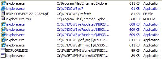

	Do a search for "IEXPLORE.EXE" and if they are any in the system files folders then it's probably a virus or malware. Should only be in 'Program Files\Internet Explorer' of course.
	not entirely true.. here's my search results..Originally Posted by deckard8
