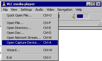

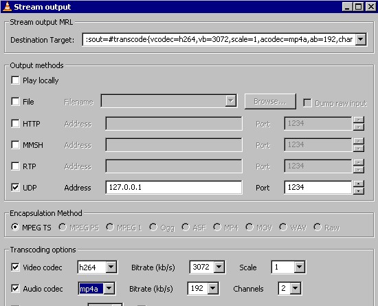

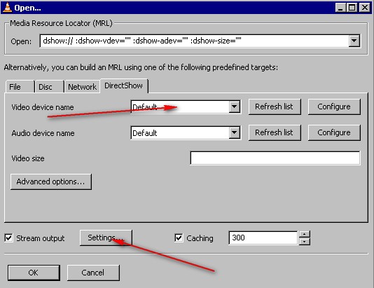

Sorry, dropped the ball on an answer for you (holidays, you know). The optimum solution would be having a very fast workstation class machine connected to the camera via firewire. On the workstation/server, you'd run VideoLan VLC in Multicast mode, and the end users would connect to the broadcast on the workstation by pointing their media player to the IP address of the high speed workstation.
A dual or quad core E6600 class machine would do it. I would install 2 or more Gigagbit network interface cards in it, then team them by giving them the same IP address. Intel has cards and software which would work nicely in this regard.
Teaming NICs for Bandwidth Aggregation
http://www.intel.com/support/network/sb/cs-009747.htm
How to Multicast using VLC
http://www.gctglobal.com/How_to_multicast_by_VLC.pdf
