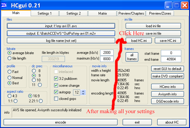

First thing is this isn't a guide to use HC. This is a guide for batch processing with HC. I'm assuming that you already know how to use HC. If you need a guide to learn HC click here.
The basic idea behind using this method is simplicity.
The idea is to use the HCgui as much as possible.
AlanHK has posted another batch method just a few posts below. His method does not use the gui at all. I suggest you try both his and my method and see which you like best.
I loaded a few avs scripts into hcgui, adjusted the settings for each (using the GUI...love this), then clicked "save ini" for each avs script.
Now close the gui.

Then create a simple batch script
And make sure to point to HCenc_021.exe and not HCgui.exe
You can change the directories to whatever you need just make sure to put quotations around the directories otherwise you will run into problems if you have spaces in the names.
Example 1: "c:\S P A C E S.mpg"
Example 2: "c:\my folder\SPA CES.mpg"
You only need to change the info in bold.
This will work for any one just change the directories accordingly in your text file.for %%a in ("F:\Directory you saved your HC_ini_files\*.ini") do "F:\Directory your HCenc exe is in\HCenc_021.exe" -ini "%%a"
Save the text as HC Batch.bat in notepad.
Just double click the bat file and watch it work.
