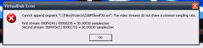

    ok I did the frame rate conversion but it's still saying there is an error appending the video:

  8. Just for the record: those two frame rates are not equal. One is 30.00030000300003... and the other is 30.0003. One solution to this would be to use AVIFrate to change both to exactly 30.
    Jul 2007
    thanks I checked in gspot and the previous error message from vdub - I have fixed this prob thanks for the help!
