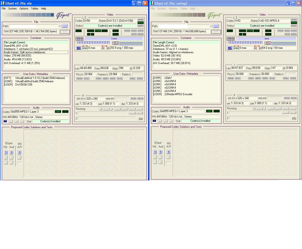

    I wasn't familiar with Gspot.... Now I downloaded it. I am just not sure which part of the whole thing you want me to post... is there a button I can click to make it give me all the info in a straight text or something? please advise and I will post it up instantly

    I think he's asking you to post a screen shot from Gspot for each of the videos. Here's a 'How to': https://forum.videohelp.com/topic271697.html

    Here is the Gspots for both files...
    PLEASE HELP guys... I am guessing the problem occurs cause the audio is "split across interleaves" on the one and "alligned on interleaves" on the other one.

    If these were shot with DV cameras then you would be better off getting the original DV source to work with.
    Looking at the two clips you have at the moment, they appear to have been re-encoded by different encoders, and with different settings. They have slightly different framerates, and different lengths. Either of these facts could account for your sync issues.
    You could try adding a .assumefps(29.97) to each avisource statement to see if it smooths things out. However, given the lengths are also different, you have to se sure that you start them both at exactly the same point, which might not be the first frame of each clip.

  8. Yeah, that's what jumped out at me as well, the different framerates. I'd say it not only could account for the out of synch audio, but is definitely responsible for it.
    I'd use an AssumeFPS for one to make it the same framerate as the one whose audio is being used. They have the same number of frames, and if they start at the same place, by making the framerates the same, they should both remain in synch. This assumes that it's the "a" one whose audio is being used, and is 30.00fps:

    here is the weird thing.. duration is different - yet frames are equal. ALSO - the sound is the same for both clips. I extracted the sound from clip a and added it in clip b and it was fully synchronized the whole time....
    The video stats are different cause 1 was shot with a MiniDV cam and the other was shot was a webcam.
