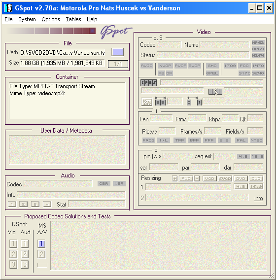

Bill. Can you open the ts in gspot and post a screenshot? Also can you zip & attach the log file please?

ok. Can the program capture to a program stream rather than a transport stream?
