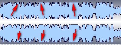

Wow, this one is tough. So many problems with it. It is going to take until afternoon/evening for the processing to complete.
Here's a clip of the audio file. Note the squared off peaks in red. That's called clipping, and it results in very bad sounding distortion. You can reduce it, you can't completely remove it, so be aware there will be some artifacts on the finished product.
The first 20 seconds contain paper shuffling that's so loud, you'll have to write that bit of it off. There's a hum throughout the entire recording, which gets worse after the 40 min mark. This isn't your typical 60hz electrical hum, either.
You'll be able to clearly hear the words when the processing is complete, but just don't expect CSI Miami, nor Cleveland, for that matter. There will still be some distortion at times, and various degrees of hum. -

Hey, thanks. Impossible to remove the buzzing without applying noise reduction, which would have introduced another type of noise. Techniques used:
Clipped Peak Limiting
Multifrequency Hum Removal
Dynamic Range Compression
Frequencies cut between 20-120hz
