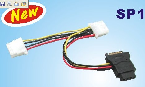

If Dell doesn't have a four pin Molex connector, then it must be a a SATA connector:
If so, you would need a SATA to Molex adapter like this:
This was from: http://www.cooldrives.com/4mooufrsapoc.html

ahh I see. So essentially I can purchase this and connect the 15 pin connectors coming from my PS to this which will create a 4 pin connector which I can then use to connect my 6pin to 2x four pin connectors (http://www.overclockers.co.nz/product/cables/6PCIE-UVB-B.jpg) coming from the GPU? I assume this is correct, let me know and thanks for the help.

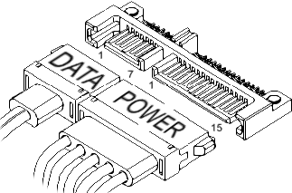

Ahh sorry not too familiar with these. It would be a 5 pin like this: http://www.atxpowersupplies.com/images/sata-connector-174x200.gif
Your 2nd post Theyuw was correct, SATA power is on a 15 pin connector....just look at the first image and you'll see they have the power plug connecting up to a 1-15 pin adapter.Originally Posted by redwudz
Looks like Cooldrives also carry a single adapter version

Actually, my mistake.
I was thinking how many wires, not how many connections. The one I linked to should work for SATA to Molex 4 pin. I never noticed how many connections the plug had to the drive.
Now I don't know that this will solve your problem, but it should at least get power to the graphics card. Hopefully that will do it.
So if I only have sata cables then I can put the sata cable (15 pin connector) into this adapter and then plug the 4 pin molex coming from my GPU into the other end/one of the two 4 pin adapters? Thanks for the help.
Yes, AFAIK.So if I only have sata cables then I can put the sata cable (15 pin connector) into this adapter and then plug the 4 pin molex coming from my GPU into the other end/one of the two 4 pin adapters?
