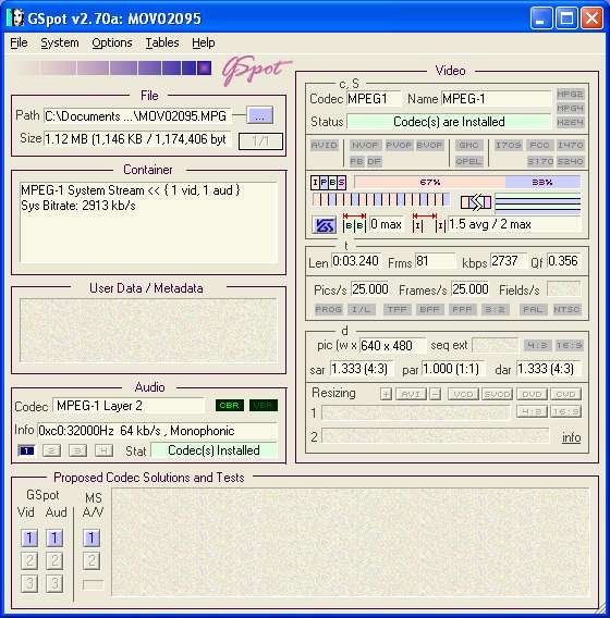

 load the MPEG into G-spot and the DV-AVI, take a screenshot of both and post the images here.

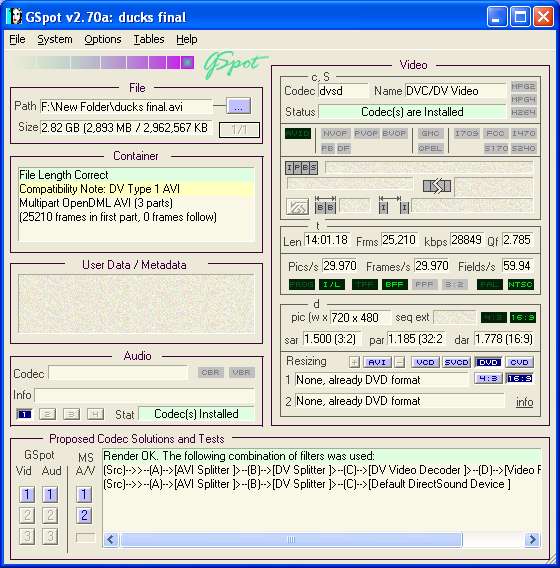

	I am not sure where to find the framerate on gspot. Here is some of the info I found... can you tell what is what?
 len 14:01.18, Frms 25,210, kbps28849 Qf2.785
 It also says Pics 29.970, Frms 29.970, Fields 59.95
 Is this the information that you need? How do I take a screenshot? I don't think I have that software.
 I did get a message at one point... on one of my many attempts to burn that asked me about PAL- that some of my files were in PAL- hmmm... what do I need to do for this?
	Well first your original video is not VCD, VCD has a set specification and that's not it. Second, the framerate is 25FPS which is a PAL framerate. For future reference look in the camers settings to see if it allows for 30FPS.
 You DV-AVI however shows the correct framerate for NTSC, I'll take wild guess that NERO is still seeing it as PAL and is defaulting to a PAL formatted disc or soemthing funky is going on with Movie Maker but that's pure speculation on my part.
 What I would suggest is going into the options for Windows Movie Maker and change the settings from NTSC to PAL for output. That will at least get it out of Movie Maker without losing your work. From there you'll need to do a PAL to NTSC conversion. Someone else can help you with that as it's not my cup of tea.
	I guess you use a Sony photo camera (like DSC-W5/W7), it has selectable PAL/NTSC (25fps/30fps) video output in menu. I can't tell whether it shoots and stores frames differently for PAL and NTSC, the screen button just says 'video out'. Anyway NTSC setting will be better for your future footage.
 There's no fair one-click way to get PAL2NTSC.
 The video you have is MPEG1 with non-standard resolution (VCD would be 352x240 with 1150kbps bitrate and audio MP2 44.1kHz) and you need to resize (to 720x480) and re-encode it (e.g. with TMPGEnc). To get NTSC DVD compliant file you have to encode it as progressive elementary MPEG2 stream (still at 25fps, don't convert fps in encoder, this gives poor results), then use DGPulldown software for setting 25=>29.97 pulldown flags. Demux and re-encode audio separately (TMPGEnc can do it; audio should be 48kHz MP2, AC3 or LPCM), then use video+audio for authoring.
