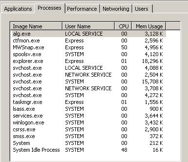

My current xp background tasks here are :
