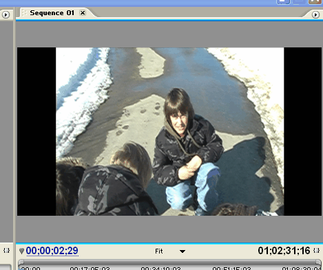

Hi I’m using 3CCD Panasonic (Gs120). Few months back I switched to 'slim' mode that squeeze pixels so it can be represent correctly on 16:9 screen.
Now I got few hours of ‘slim’ tapes but when I try to import those I got 4:3 picture in 16:9 movie.
Is there way to easily stretch horizontally only (not zoom), this should be the same as modify pixel ratio?

With the same result the DV capture is 4:3 but the picture inside is ‘slim’ (16:9) ready to take whale 16:9 screen. Because data in the DV file specify this as 4:# with square pixels it is shown as below.
Panasonic GS120 doesn’t have true 16:9, it has ‘slim’ mode that electronically squeeze pixels.
I think that if I could change the aspect ratio of this data file it would look just right.

Premiere does acknowledge whether the 16:9 flag is set and displays the DV AVI clip in the program monitor accordingly. Note that whether this flag is set or not has little to do with the actual appearance of the video. Depending on the camcorder involved and whatever processing the clip went through, this flag can be set & reset regardless, and as in the clip presented by andy27 Premiere may display a supposedly 16:9 clip as a squeezed 4:3. Setting the clip's aspect ratio in interpret footage may help, or not (if it is already 1.2). One other way to correct it is (before cutting it up in editing) is to click in the clip's motion properties, uncheck the maintain proportions or ratio, and change the horizontal from 100% to 133%. The vertical should remain 100%. Ignoring the left & right black bars when Premiere wrongly senses a 16:9 clip as 4:3 and editing away anyway is NOT an option. The black bars are there because it means Premiere sensed the 16:9 flag wasn't set, and will remain that way with the still black bars present in the edited output & the particular clip still squeezed.
