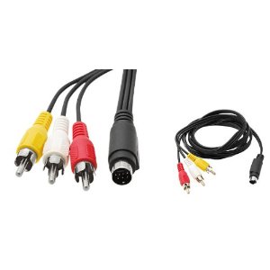

    I have a Compaq Presario V5233EA laptop which has a VGA port and also an S-Video port (7 pins). But my Sony Trinitron TV is about 4 years old and does not have an S-Video in (only the RCA jacks i think). What is the best possible way to connect them so that i get the laptop screen on the TV?
    Out of the VGA and the S-Video ports which one will result in better quality on the TV?
    Please if possible can you guys upload a picture of the cable that i should buy?

    Connector widely used on ATI and other graphics cards. Carrys s-video and composite signals
    Some sources report that pin 6 is Composite video, pin 7 - composite ground
    Generally the first four pins on those 7-pin connectors on the same places as the standard four pin S-video connector have practically always the same fuctionality as those pins in S-video connector
    Yes , the 4 pin will fit , but only black and white output under rca .
    While quality on screen may not be the same as on the pc screen , it also depends if you set your pc screen to its lowest resolution , which helps .
    Trying to send 1600x1200 wont ... and make any fonts impossible to be read which increase eye strain .

    Well , I finally got them , all 3 and a free one thrown in , and guess what .
    I have colour now , so I know what I was talking about in the first place when it came down to how the standards had become muddled by manufacture's over this time and why there is much confussion , and why a cable that should have worked , simply dont in most case's .
    Dell latitude , D series , use's pin 2 and exterior din shell > rca outer shell , and pin 5 > internal rca connector , for color output via rca .
    So in the case of dell for the particular model mentioned , they do infact , go against the standards , but followed the s-video output standards ... pity its in BLACK and WHITE ... idiots .

    I had the same prob and I bought a 7 pin S video to 3RCA cable (something similar to the one on the figure) Name:  41-oprCyfeL._SL500_AA300_.jpg
Size:  10.2 KB. It half serves the purpose. I can see the images but not audio. Is it something wrong with the cable or the TV or is there any settings that I should setup to get the audio to TV?
    some advise is greatly appreciated.
