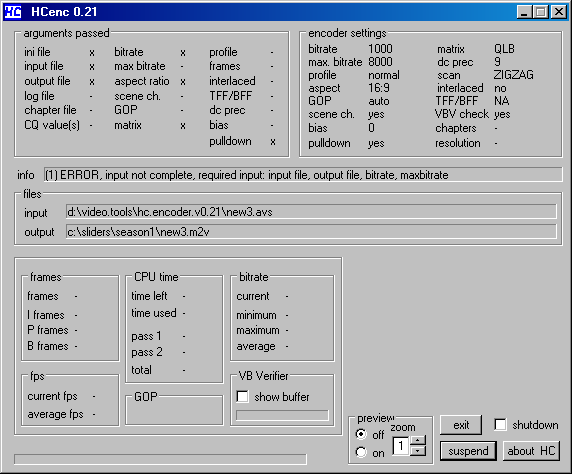

    When I double-click it, HCGui tells me:
    "ERROR, input not complete, required input, output file, bitrate, max bitrate"
    What am I doing wrong?

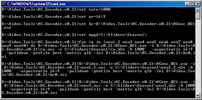

    You can see where it's looking for the file new3.avs.
    Is that where it actually is?
    When the batch begins executing you should see in the DOS window it echoing its parameters before executing them -- expanding each filename variable.
    If I execute my file, I see:
    P:\DVD>set rate=1845
    P:\DVD>set ar=16:9
    P:\DVD>set hc=P:\HCenc\HCenc_021
    P:\DVD>set mpgd=s:\mpg\
    P:\DVD>for %a in (dw207 dw208 dw209 dw210 dw211 dw212) do P:\HCenc\HCen
    c_021 -i P:\DVD\%a.avs -o s:\mpg\%a.m2v -b 1845  -aspectratio 16:9  -pu
    lldown -profile best -matrix qlb -ini P:\HCenc\hc0.ini
    P:\DVD>P:\HCenc\HCenc_021 -i P:\DVD\dw207.avs -o s:\mpg\dw207.
    m2v -b 1845  -aspectratio 16:9  -pulldown -profile best -matrix qlb -ini P:\HCen
    c\hc0.ini
    P:\DVD>P:\HCenc\HCenc_021 -i P:\DVD\dw208.avs -o s:\mpg\dw208.
    c\hc0.ini
    P:\DVD>P:\HCenc\HCenc_021 -i P:\DVD\dw209.avs -o s:\mpg\dw209.
    c\hc0.ini
    For instance:
    c\hc0.ini
    Shows the fully expanded command line for the file dw207.
    It's a bitch getting the syntax right, but when you do, after that it's only a minute to set up each job.

    D:\Video.Tools\HC.Encoder.v0.21\HCenc_021.exe -ini D:\Video.Tools\HC.Encoder.v0.21\vid3.ini
    But backing up, the screenshot shows HC trying to open
    D:\Video.Tools\HC.Encoder.v0.21\new3.avs
    as input, but saying this is "incomplete"
    If this AVS file is there, it should work.
    Though I see you have removed spaces from your filenames, all the periods might be a problem. Remember that batch language is very old fashioned when it comes to filenames.
    Sep 2006
    Yep. Agreed. Underscores are best with command-line.
