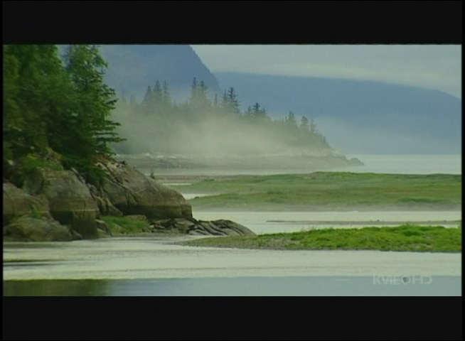

    I gotta tell ya, SD downscaled recording from a 1080i/720p ATSC/QAM input can be pretty fine quality. SD ATSC/QAM source is a huge step up from analog NTSC.
    Sure HD recording would be better but for now quality SD is fine.
    I have two ways to record locals in HD when needed at the computer: Off the cable box IEEE-1394 output (solid) and directly with the Hauppauge HVR-1600 (getting there).

  23. Both the LG RC797T and Panasonic DMR EZ37VK with ATSC/QAM tuners I have tested produce 720 by 480 captures. The LG uses the LSI DMN8604 chip. From the posts above it would appear the Panasonic uses an LSI chip also but I have not opened that unit yet.
  24. Member edDV's Avatar
    Mar 2004
    Northern California, USA
    Do the 720 captures show the 8 pixel black side edges or do they stretch 704 to 720?
  25. I posted my results here,
    https://forum.videohelp.com/topic279460.html
    but I just examined the png files from virtualdubmod. It looks like they both add black bars to the sides but for some reason the left bar is skinnier on the LG where the bars are the same size on the Panasonic.
