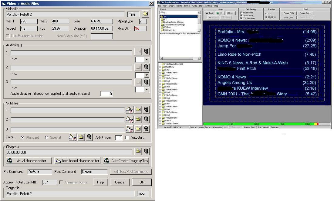

Placing the MMC capture files (*.mpg) onto the GUI workspace (an initial step), Video configuration window immediately pops. MUX is listed as "No". Click "OK", and I immediately receive error message saying that "Navigation Packs" are missing, and indicates DVD Create process will likely fail. If I ignore warning anyway, later DVD Create process fails. GFD help file, forum, and Google searches suggest that my MPG files need to be multiplexed, and that MuxMan will likely take that format of MPEG2 file.

Sample Video Config Window and sample menu format follow. (Picture can be expanded for clearer reading.)
