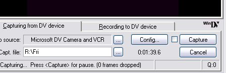

    Where and when does WinDV tell you if there were dropped frames? It would be good if it told you dropped frames while capturing so I dont have to find out at the end that there were dropped frames.

    Bottom Status bar.
    It usually works except for some reason, WinDV doesn't report when a hard disk is full.
    Jun 2007
    Awesome! Does it report dropped frames while capturing or only at the end of the capturing process?

    real time
