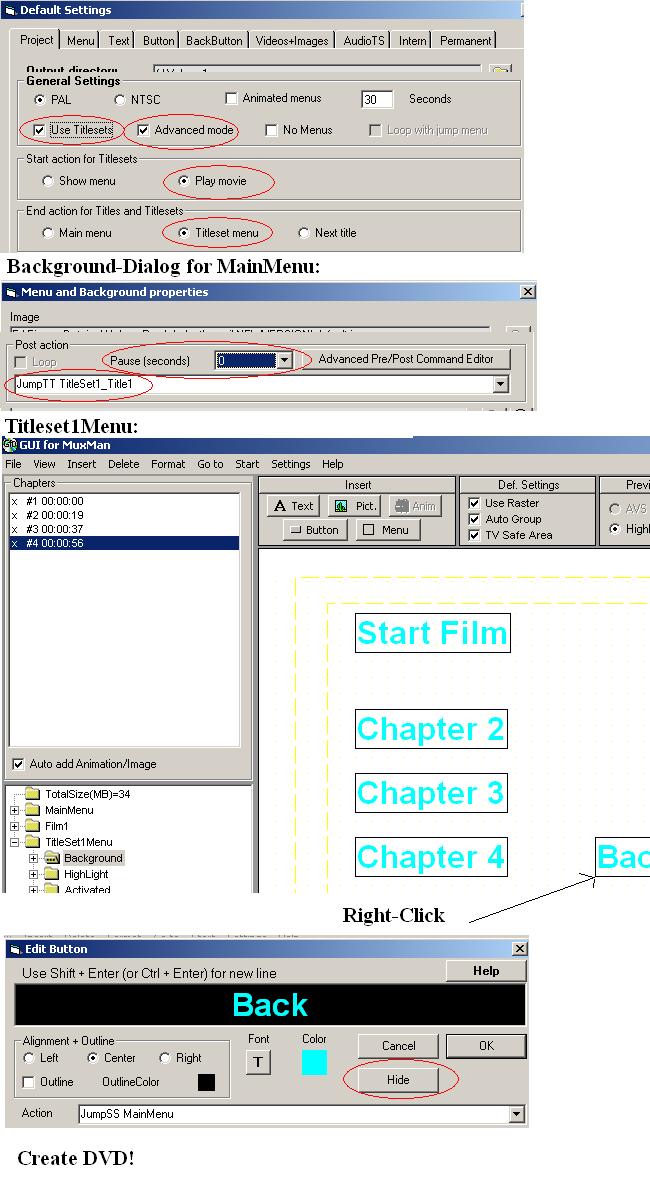

It's quite easy in GfD, the 'best way' just depends a little bit on some other topics:
- Is an intro used
- Are you using titlesets
- How many 'films' are on the DVD
Most easy: One movie with titlesets
Use 'Start title' as 'Start action' and 'Show titlesetmenu' as 'End action' in the default project settings. Add your movie and set up a post command for the MainMenu as described here:
http://download.videohelp.com/gfd/Help/MenuPostActions.html
(use pause=0).
Design the Titlesetmenu as the 'play menu' in the way you want it to be shown after the movie has (auto-)played. Hide the 'Back-Button'.GUI for dvdauthor:

thanks borax, i'll give it a try
I did get one to auto play with gfd, but it stopped on a black screen at the end of the movie instead of going to my menu
these disc/files in question are (1) movie, i use a still scene for the menu background and only a play text/button -
I tried your method and aedipuss method several times
I get the same thing
autoPlay, but stops on a black screen at the end of the movie

I'm sure that it is possible (also with GfD), as I have tested it without problems. If you are still interested, post (or send by mail) the Author.xml file from the project. Then I can have a look.
GUI for dvdauthor:
https://www.videohelp.com/~gfd/ -
thanks Borax, the next one I do, i'll send you the file

Ok. Here is a simple example (using MuxMan as engine).
