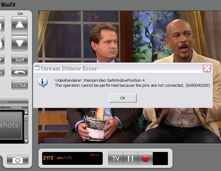

    Attention DirectShow experts!
    I'm evaluating a Hauppauge HVR-1600 with the new Beta Version 3.4D1e software with QAM cable tuning.
    I've been experiencing crashes that seem related to the ATI Catalyst driver and explorer.exe (Windows Explorer).
    Now I'm seeing the following DirectShow error. Any ideas what is going on?
    What does this error mean?

    The last program installed was that WinTV 6. Should I reinstall it?
    I think I'll reinstall the ATI Catayst driver then reinstall WinTV.
