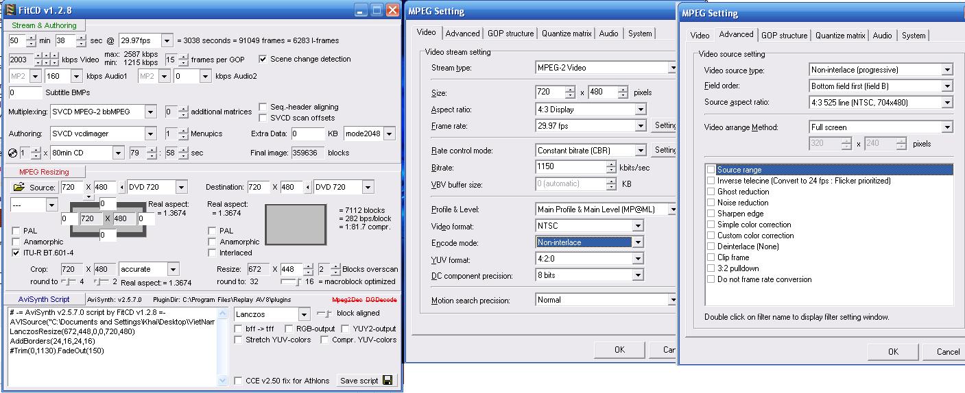

Thanks, manono. I have tried this through the guide and it is worst then rendering in VEGAS. Let me tell you the steps I went through so maybe you can point out my mistakes:
1. Start FitCD, and in "MPEG Resizing," I clicked "Source" and selected my DV-AVI file.
2. In "Destination," on the right, I clicked "DVD 720" option.
3. Unchecked "Interlaced" and set "block overscan" to 2 with frame size of 672x448.
4. Left everything by default as stated in guide and choose "Lanczos" option on bottom right.
5. Save script.
6. Drop script, "(Unknown) - Clip 001.avi.avs" in TMPGenc Plus.
7. Went to "Settings" at bottom right and in "Video" tab.
8. Changed "Stream type" to "MPEG-2 Video"
9. Left size of 720x480 alone and everything else except changed "Encode mode" to "Non-interlace"
10. Went "Advanced" tab and change "Video source type" to "Non-interlace (progessive"
11. Changed "Video arrange Method" to "FULL SCREEN"
12. Then Ok and Start to convert.
Thats when it got all choppy. I appreciate any help. Thank You.

I don't use TMPGEnc, so I can't be of much help there. There are plenty of others around here that can help. I only happened to notice that you set it up to encode for progressive, and I thought that DV was, by definition, interlaced. It also makes a big difference in how the script is written. Also, your bitrate is ridiculously low. Maybe you have a reason for doing it like that; I don't know.
TMPGEnc accepts the RGB colorspace, so you should convert in the script, rather than letting TMPGEnc do it (is it already RGB?). And because no cropping is being done, you can leave that out and rewrite the script like this, assuming your source is interlaced:
AVISource("C:Path\To\Video.avi")
SeparateFields()
LanczosResize(672,224).Weave()
AddBorders(24,16,24,16)
ConvertToRGB24(Interlaced=True)
And since that's not the best way to handle interlaced resizing, I'd really do it like this:
LoadPlugin("C:Path\To\LeakKernelDeint.dll")
AssumeBFF()
LeakKernelBob(Order=0) #for BFF source
LanczosResize(672,448)
SeparateFields()
SelectEvery(4,0,3) #keep it BFF
Weave()
I don't know; maybe you already deinterlaced in Vegas. Anyway, test out the script in VDub(Mod) first to make sure it's OK, before sending to your encoder. And encode for BFF.
