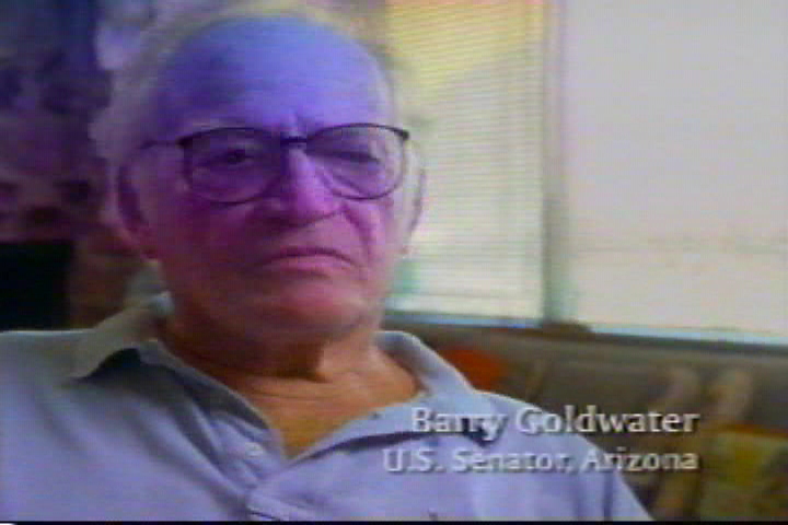

I'm having a similar problem capturing from my VCR to a KWorld DVD Maker PCI card. I get intermittent color distortion across the top of the video image. I was going to try with another VCR, but your post is making me wonder if that will work. Below is a particularly bad sample. Does anyone know what's going on here?
