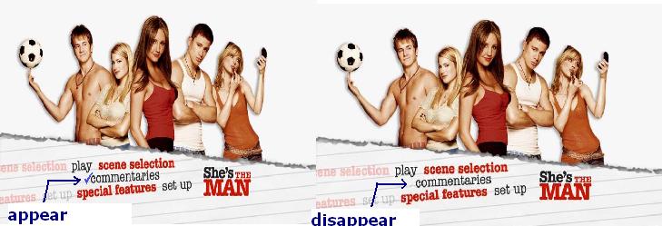

usually there is an object ( something like a pointer ) next to buttons in still menus that shows button is ready to be selected. ( like a circle, star and etc )
but when i changed background that objet disappeared.

in static menus when you want to select a button to play your movie next to the selected button something like a circle or a star or etc will show up. like the left picture.
but after all things i said nothing appears. like the right one.
what should I do to bring back that blue check?

i chnaged the menu background ( the picture ). when i play dvd on a dvd player to watch on TV everything works fine but the pointer next to buttons does not appear. like the picture above.
what should i do to bring that check back?
how can I make anew pointer?
is this possible to make a new pointer? -
