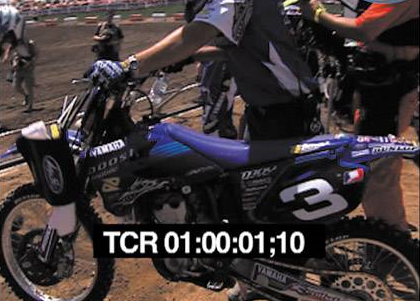

    An edit decision list (EDL) is a list of scenes or clips with in and out time codes.
    In production, it is common to receive a dubbed tape with time code overlayed in a window like this.
    The editor makes edit decisions and enters the in/out time code into a list. The capture software will use that list to capture those clips from the original tape and ignore the rest.
