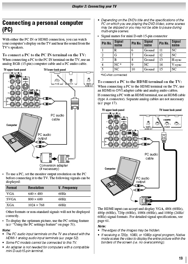

This is the page from your televisions manual:
In case you are wondering I got the PDF from the Toshiba website.
My guess is that your laptop just has a standard VGA out so no adapter should be needed.

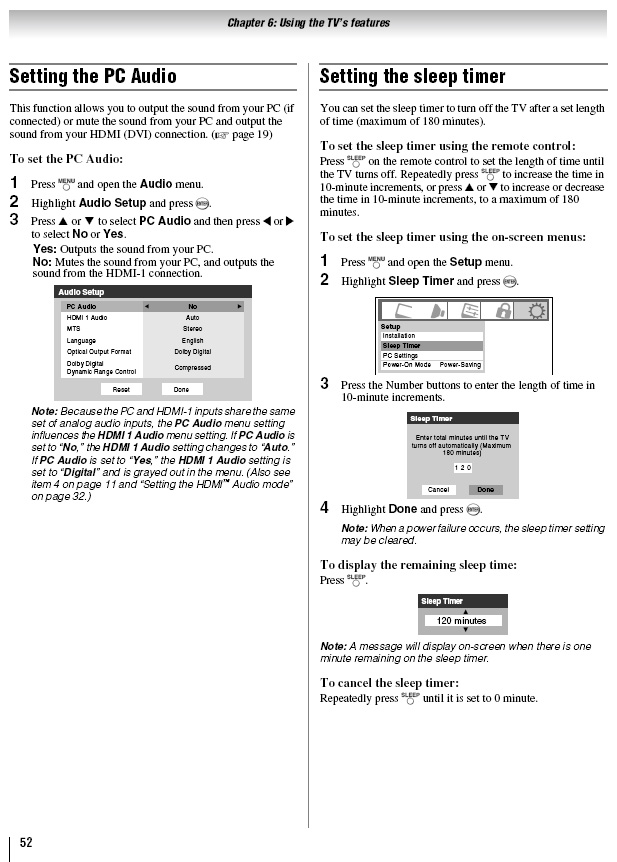

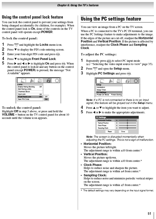

You will also need page 51 and 52 so since I am in such a good mood right now:
Now all you need to know is what kind of VIDEO OUT is on your PC but my guess is that it is a standard D-sub 15-pin connector. However even if it is DVI you can still do it as the INSTRUCTION MANUAL OF YOUR TV clearly ... did I say clearly ... states.

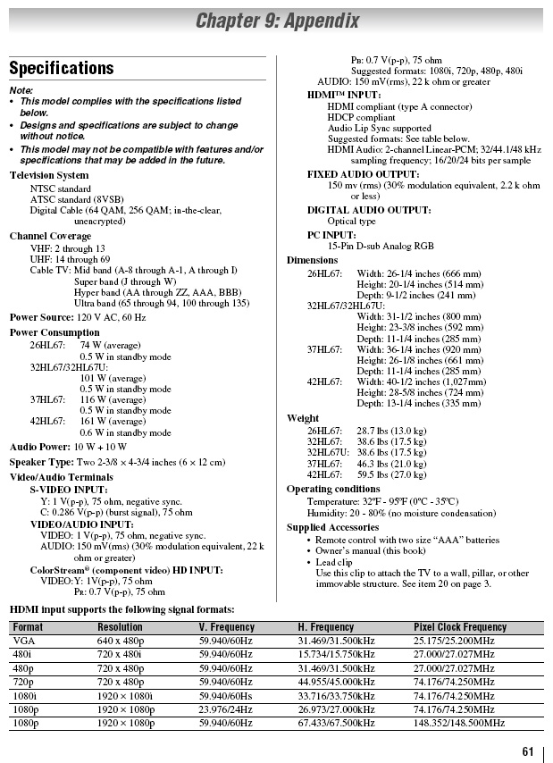

Here also is page 61 ... note the stuff at the bottom of the page about the HDMI resolutions ... this is in case you have a DVI out on the laptop:
use the VGA cable, set the laptop to is max res display
on the TV select the VGA input then select the aspect ratio/dispaly setting
something like 1:1 or ASPECT or zoom
until you have the picture you like
turn on the TV before you turn on the PC, the PC has to detect the LCD montior plugged into the VA port or it won't send a video signal to it -
The MAX resolution that the TV can handle via the VGA input is 1024x768 @ 60Hz ... this very well may be the MAX resolution that the laptop can put out but surely going higher than that, even if the laptop can, would not work very well. In fact it wouldn't work plus it could damage the TV.

I do have a 15-pin connecter on my laptop. So now all I need is a VGA cable. I'll get one tomorrow, hopefully from Walmart or Circuit City or somewhere like that. My only hope is that it displays well.
