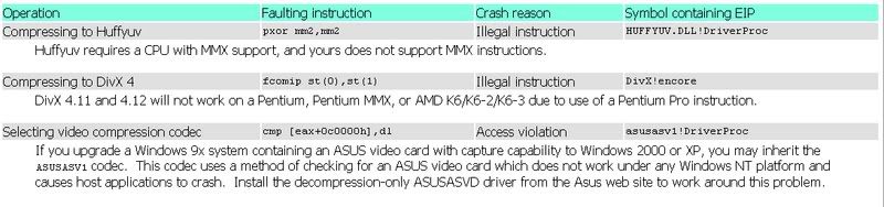

This is one thing I found that my be the caus for all the crashes:
I have a feeling it may be the last one... I don't know what videocard I have but I do have an Asus motherboard. P4P800 Deluxe if it is to any help.
I Tried to find this "decompression-only ASUSASVD driver" withoud luck... Asus hompage sucks some serious donkey-doodle.
