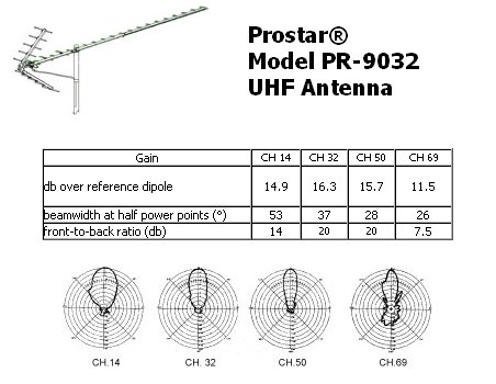

I have a moderately large VHF antenna in the roof pointed at Chico-Redding and get a moderate signal for one station (12). I'll need a large UHF antenna + preamp eventually to reach 60-119 miles for DT.
This thing is 10 feet long. -

But that antenna would never work at 60-120 miles. Fringe reception requires a highly directional antenna plus amplification.Originally Posted by Heywould3
yeah thats true but i was thinking that you might have a station closer that isnt listed anywhere that you might get.. even if its only one.
I wish. If I could raise a mast 500 feet, I would get about 40 stations.
