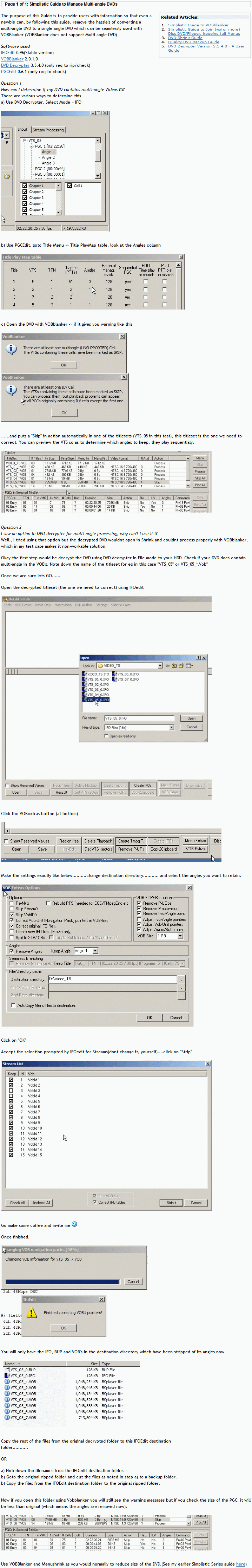

    Aug 2006
    I've run into this problem before with multi-angle DVDs. DVD Decrypter apparently has problems with multi-angle titles; even though it gives you the option to rip only one angle, this does not always prevent the out-of-sync problem. It effects Ripit4me through its use of DVD Decrypter.
    There used to be a guide on Digital Digest that I followed which allowed me to fix the problem. Unfortunately, when I just checked the link to it, it was gone. I guess it got flushed in the aftermath of the Ripit4me thing.
    Fortunately, I had a saved copy. I don't think it's breaking any rules to post it, but if it is then please take it down.
    I made an 8-bit png out of it but it's still about 320KB.
    The procedure you want begins under "Question 2" with the words: "Okay the first step would be decrypt...". There are pictures to guide you through all the steps. Once you get your new folder, just run it through AutoGK as usual. This method has always worked for me (though I've only used it a few times). You'll need IfoEdit. I have used it both on AnyDVD/DVD Decrypter (file mode) rips and once on a rip from Ripit4me in "Full DVD" mode.
    And here it is:
  6. Wow...I really appreciate you going through all this effort to help me out! I will give it a whirl and post the results. Right now the file is encoding in this avi.NET the first replier told me about so we'll see how that goes as well.

    Well, I wound up just cancelling the avi.NET encoding process because I was more eager to see how the IOFedit-ized rip would work in AutoGK.
    I am pleased to share with you that it worked perfectly! Thanks again for all your help!
