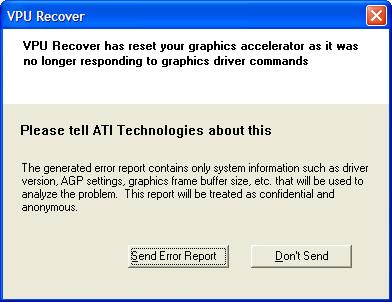

I've recently started having trouble with my monitor / display in varying degrees, and often get the following message:
Sometimes the cursor goes to a black block and / or then the screen freezes followed by a reset and the error message. Other times it just hangs and I have to reboot the mobo by holding the power button for 5 seconds.
I've taken a look at the Event Viewer but can't see anything in there that sheds any light on what might be going on.
This can happen very soon after start-up (cold system) or when it's been on for a while.
I suspect that my graphics card is dying, but wanted to check a few other things before I get a new one.
* Is it likely to actually be the graphics card?
* Could it be down to needing a good clean (i.e. dust / fluff)?
Cheers,
Daamon.

It could be the card, I've never seen that error. Have you uninstalled and reinstalled the video card drivers? That might rule out software problems. If you haven't checked for dust or cleaned it out lately, sure, give that a try. The way graphics cards run so hot these days, overheating may be fairly common.
If a reinstalled driver doesn't help, last thing is to boot in safe mode and run it for a while and see if you get the error. That should use the Windows drivers just in the off possibility that you have the wrong ATI drivers installed.
Other than trying the card in another computer or trying a different card in yours, I can't think of much else. -
Hey daamon I think I had that error on my old ati 9250 I used to have. Then the screen would get sripey green lines all over it. I finally bought a nvidia 5500 to replace it and the problems never came back. I think it might have been the graphic error message your getting.
If your start getting green lines I'd say replace the card quickly or switch to onboard graphics if you have any until you find a replacement card.
HOpe that helps again I can't remember verbatim if that was the same message as that was quite awhile ago but it was an ati card.Donatello - The Shredder? Michelangelo - Maybe all that hardware is for making coleslaw? -
see if this helps:
http://www.foxpop.com/imre/2005/vpurecover/vpurecover.html -
You can also disable the "auto gpu recover" feature. It is the video drivers way of "helping" you to recover from errors, which are quite often driver/software related and would likely go un-noticed anyway. nVidia has a similar feature in their drivers.
Google is your Friend -
Only time I have ever seen that error it was a driver problem, with the ones on the installation CD. Downloaded different drivers, had to try two or three, but new installation solved the issue.
Information on the model of card, and most particularly its age, would be important for a correct diagnosis.
Cleaning never hurts, and reseating the card in the slot could well be the answer. Most especially if anything has been installed internally that might have flexed the board. I have one board that if I breathe on it too hard, it won't boot until I reseat the Video card. -

Yes, but I read that that was there to prevent the "blue screen of death".Originally Posted by Krispy Kritter
It's in my computer details, and is nearly three years old. But immaterial now, given the above confession...Originally Posted by Nelson37
I should say that I updated the BIOS to the latest version, and installed the latest drivers for the precise model and from ATI - all to no avail. No internal hardware changes have been made in a long time that may have knocked the card (or anything else). On top of that, the card has been working fine until recently and on the original from CD drivers. All of this leads me to believe that it was probably the card just dying naturally.There is some corner of a foreign field that is forever England: Telstra Stadium, Sydney, 22/11/2003.
