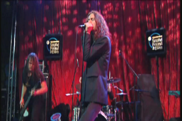

	Garbage In Garbage Out. But you might do something with some filters. Could you explain how the video looks like? blocky? blury? or post a screenshot or a short sample.
	In Media Player Classic select File and Save Image instead. Then upload it when you post a reply(under upload image/file).
	ok here it is, it doesn't seem as blocky as the pic shows when the actual file is playing.

	Though it doesn't have MPEG exporting, you could try VirtualDub Mod and a deblocking filter, then frameserve the output to a MPEG encoder. VD has many filters available. Here's a few:
 http://www.thedeemon.com/VDFilter/list.html
 Or here: http://neuron2.net/
 A couple of MSU deblocking filters:
 http://compression.ru/video/deblocking/smartdeblocking_en.html http://compression.ru/video/deblocking/index_en.html
	There are no marco block in th posted snap shoot. De-blocking filter will not help.
