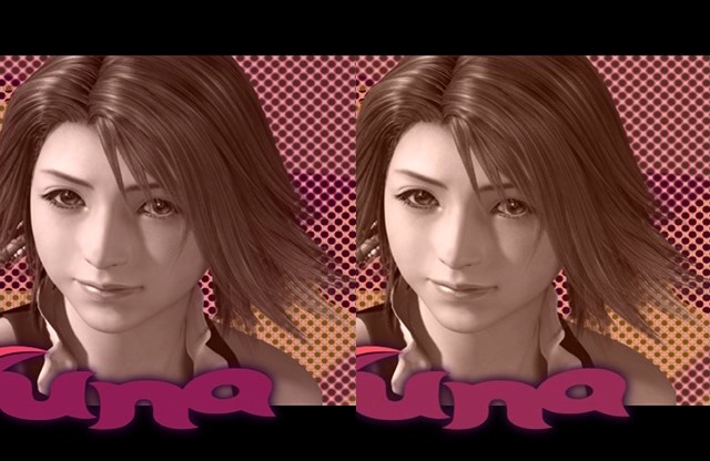

  22. By the way, the colorspace problem with VirtualDub effects your yuna.mpg file too. I recommend using VirtualDubMPEG2 if you perform any filtering on it. Or use AVISynth to do all the filtering, then any version of VirtualDub in Fast Recompress mode for compression. Here's a sample with VirtualDubMPEG2 on the left, VirtualDubMod on the right:
    The difference isn't huge but it's noticeable.

  26. Originally Posted by jagabo
    Through some experiments I've been running to examine this issue I've accidentally discovered that VirtualDubMod has a colorspace conversion problem with MPV files from CCE, but not with MPG files from TMGPEnc. It appears to use the rec709 matrix rather than the rec601 matrix when converting from YV12 to RGB.
    I don't understand. Everything out of CCE uses BT.709. That Yuna.mpg also is BT.709. I guess it's TMPGEnc that outputs BT.601? I wouldn't know as I don't use it. But if true, it's the TMPGEnc result opened in VDubMod that looks darker. I think. From the ColorMatrix filter doc:
    ColorMatrix corrects the colors of MPEG-2 streams of dvds. More correctly, many MPEG-2 streams use slightly different coefficients (called Rec.709) for storing the color information than AviSynth's color conversion routines or the XviD/DivX decoders (called Rec.601) do, with the result that DivX/XviD clips or MPEG-2 clips encoded by TMPGEnc/QuEnc are displayed with slighty off colors (which looks like a small difference in brightness). This can be checked by opening the MPEG-2 stream directly in VDubMod.
    how do you know wat colorspace a video uses??
    Open the MPEG/VOB in DGIndex and run the Preview. That will show the colorimetry used. You can get the colorspace used by adding Info() to the bottom of your script, among other ways.
    with a HVS correction it's easily fixable in my opinion
    Another reason to frameserve using AviSynth. As long as you know what you have and what your encoder is expecting, just use the ColorMatrix filter.

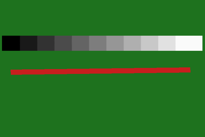

    I don't understand exactly what's going on. But CCE encoded MPV files have different colors when opened with VirtualDubMod compared to any other program. Here's what I did in my testing:
    1) I started with a 24 bit RGB BMP image like this one (converted to lossless PNG here to reduce the size)
    2) I made a short uncompressed RGB AVI file out of it with VirtualDub. The colors of this AVI file are exactly the same as the original BMP file when viewed with any program.
    3) I opened that uncompressed RGB file in CCE and TMPGEnc Plus and encoded to MPEG2 with NTSC DVD compatible settings. Pretty much the default settings of each program (except the low pass filter was turned off in CCE).
    4) When the CCE encoded MPV file is opened with VirtualDubMPEG2 the colors look like the originall image and the original uncompressed RGB file. Exporting a frame and measuring the RGB values indicates that they were all within 1 or 2 of the original image. For example, the green background of the original AVI file was 30,114,30 (R,G,B). Opening the MPV file in VirtualDubMod gave 29,113,28. This is the typical RGB->YUV->RGB conversion error. I opened the MPV file with several other programs and they all looked like this -- except VirtualDubMod.
    5) When the CCE encoded MPV file is opened in VirtualDubMod the colors are obviously different. After exporting a frame and checking the RGB values the green background was 22,100,25 instead of the original 30,114,30. The red bar was off color too. The gray patches were all within 2 of the original.
    6) DGIndex shows the MPV file's colorimitry to be ITU-R BT.709. Using a simple AVISynth script to open the MPV file:
    MPEG2Source("file.d2v")
    ConvertToRGB() #equivalent to ConvertToRGB(matrix="rec601")
    gives the same colors as the original image, within 1 or 2 on each subchannel.
    7) Using the rec709 matrix instead
    ConvertToRGB(matrix="rec709")
    Gives colors similar to those obtained by opening the the MPV directly with VirtualDubMod.
    8) Opening the TMPGEnc Plus encoded MPG file with VirtualDubMPEG2 and VirtualDubMod gave the same colors as the original image within the expect error range of 2 on each subchannel. AVISynth's default ConvertToRGB() also gave the same colors. ConvertToRGB(matrix="rec709") gave the wrong colors just like opening the MPV file with VirtualDubMod. DGIndex reports the colorimetry of the MPG file as "FCC".
    9) I repeated the experiments using a HuffYUV compressed (RGB-->YUY2 mode) version of the the uncompressed RGB file instead. All results were exactly the same. So HuffYUV converted to YUV the same way as CCE and TMPGEnc Plus.
    In short, all programs open the CCE encoded MPV file and decode to RGB giving colors similar to the original uncomrpess RGB AVI. Only VirtualDubMod gives different colors, colors that correspond to using AVISynth's ConvertToRGB(matrix="rec709").
