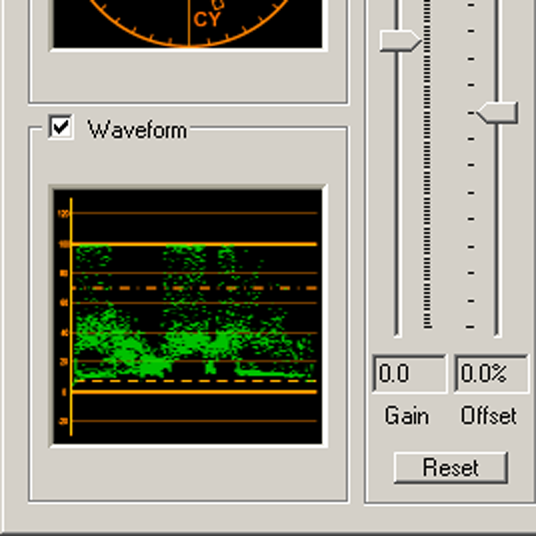

OK, I'm giving it a whirl. I've read through the proc-amp part of the help file and have a couple of questions...
Is there any way to make the waveform display larger? It's very hard to read the markings on the vertical scale. Is the lower dashed line at 7.5 IRE? What does the upper dashed line represent? It looks like it's at 70 IRE.

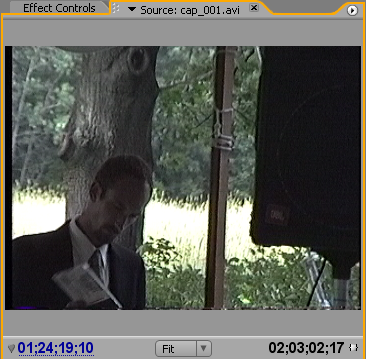

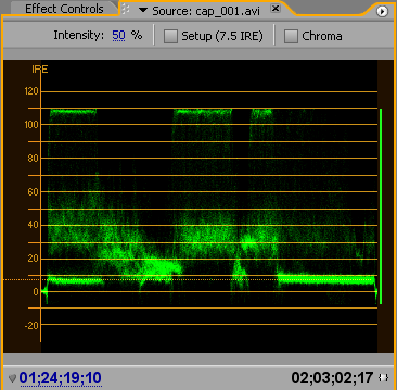

Here's the original image as shown in the Premiere Pro 2.0 source monitor (this is a direct DV capture from the camera over Firewire done with DV Processor):
The PPro YC Waveform display is what originally clued me in to the black level problem. It definitely looks like setup has been added by the Sony TRV350 D8 camcorder. This makes me worried that maybe the brighter values up around IRE 110 have been crunched at the high end by the camera when it adds setup...
The DV Processor proc-amp waveform display shows something similar before making any adjustments, although the blacks seem to be even higer than IRE 7.5. I also see that the brighter values are shown to be at 100 instead of 110 as shown by PPro.
When I set the Luma offset in the DV Processor proc-amp to -7.8% the upper values get shifted down, but now the blacks seem to be right at IRE 7.5 according to the scale on the left...
Shouldn't they be moving closer to IRE 0? -
I ran DV Processor on a segment of DV video (same file as the one the composite still in my last post came from) and set the proc-amp to -7.8% Luma offset. When it was done I loaded the output and looked at it in PPro's YC Waveform monitor. All fixed! I compared the before and after versions and DV Processor did a wonderful job.
My theory is that the odd waveform displays in my last post can be attributed to the drawing code in the DV Processor waveform monitor. There are a couple of other issues with the proc-amp interface but they seem to be with the GUI code and not the video processing itself.
