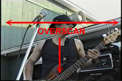

Here's a sample, this is normal and will appear on just about any footage captured from a analog source. Note the left and right are fairly clean but noise appears at the bottom in this shot:
As far as why it became better with the lower bitrate is because the less bitrate you use the more detail that is lost especially where there is a lot of motion. End effect is the reencode smoothed these areas out a little. As Guncslinger suggested best to get rid of it is to crop and add borders or mask it depending on the software you are using. -
