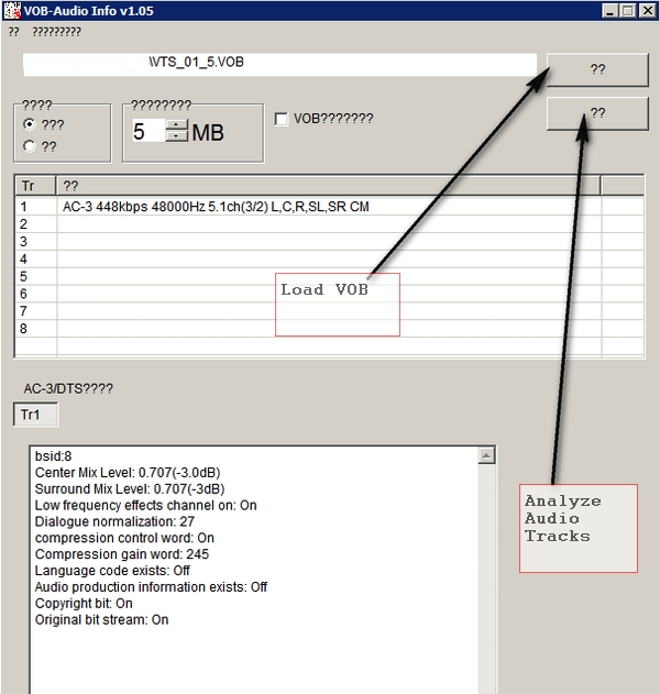

There are lots of apps that can do this. I like this tiny utility called Vobaudio. It's from Japan, but the app is incredibly simple to use.
vobaudioi105.rar
Edit - Whoops, just re-read your question and realized I didn't answer it. 2.0 is stereo, anything that makes it sound otherwise is coming from your playback software or hardware. -

Thanks. The program works. It indicates whether the track is Dolby Surround encoded or just L, R, center mix.
Like I said, it's guessing.
Hope it guesses well...
Scott -
It says L,R,CM for both stereo and surround but in the information it will tell you whether it is "encoded" for Dolby Surround so I'm guessing there's a file flag or something that the program reads.

After rereading the OP, I realize one of the things you're talking about is AC3/DD tracks on a DVD.
In this respect, YES, there is a data flag in the stream that states: Encoded4DolbySurround/NOT/Don'tKnow. This ought to just apply to 2.0 mixes.
