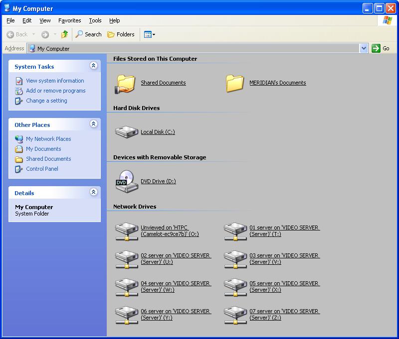

    Just to add, networking is fairly easy on XP. The 'Wizard' does most of the setup. I've had a few weird problems as I have learned how to hook everything together. Networking can be a little complex because both computers at either end have to be able to communicate with each other more or less equally. XP home is not quite as simple as XP Pro for networking, but I have used both. I presently have 5 computers linked together with both a router and a switch and they all get along fine. I haven't got any wireless setup, but it should be similar.
    It all has to do with permissions. One computer has to agree to accept the data from the other computer and visa versa. That's what setting up sharing is all about. But work with the Windows help setup and the Wizard and it should all come together.
    When it works, it's very nice. I set my server drives up for sharing on all my computers and 'map' them. They just show up on each computer as another hard drive and I can access any of them from any computer. This from my laptop. It just shows the video server, the other computers drives aren't mapped. I'm going to add another server in about a week with eight additional drives.
