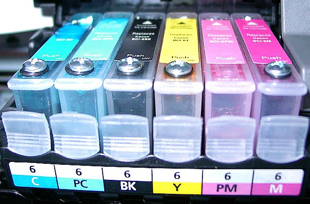

Drill a small hole in top of cartrig, suck ink into syringe, slowly squirt ink into tank till full, squirt rest of ink back into bottle. Hot glue over the hole and press alittle for a good seal. Refill all the tanks fast with no real mess!
You do need to save the twist off caps that you snap off the bottom of the tanks when new, you hold those in place tight while refilling so ink does not come out the bottom untill after you hot glue the hole shut on top.
It's nice to have a syringe for each tank so you can just do them all at once then rinse them with clean water and be done. With 1 syringe you need to rinse between each color but ti works ok.
Syringes are plenty full and cheap, check pet stores or feed stores etc.. $0.49 for the last ones I bought. I use them for other things also like squirting glue under a floor tile or such that is loose or bubbled up and can't get to the back side. -

just incase the page is removed , here's the pic I though not a bad method .
