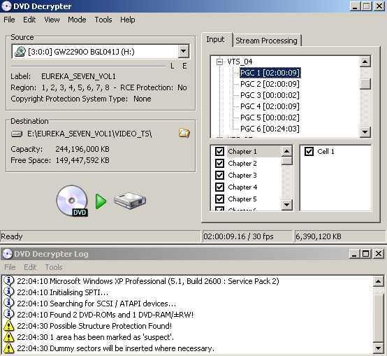

This is a pic from DVD Decrypter so you can see how the DVD is structured.
As you can see, these is more than one PGC that have the same timing. After extracting them all in full, I've noticed they are exactly the same(most probably all linking to the same source PGC?).
Basically, when I use Ifo Mode in DVD Decrypter, I only extract the episode I want (using info obtained from Power DVD's info feature, but as you can see it's not fairly accurate) and have the audio (AC3) demuxed.
When I import them into a MKV container, the subtitle adds and extra episode length to the file (total 47 minutes instead of the usual 24 minutes). The Audio is out of sync by roughly 1 second.
