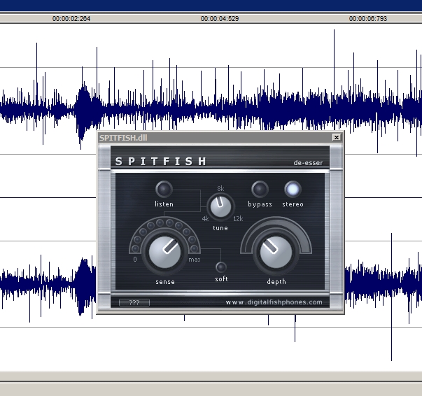

    Actually it is vocal stuff. A female's voice. To make it even harder to clean up, her "s"'s create their own kind of hiss :/
  4. Member Soopafresh's Avatar
    Jan 2004
    You can find several De-esser plugins which should reduce the problems with "S" sounds.
    http://www.digitalfishphones.com/main.php?item=2&subItem=5 Spitfish
    You can load it into Wavosaur or your favorite VST compatible audio editor.
    http://www.wavosaur.com/
