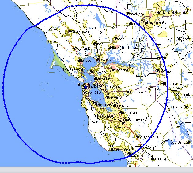

    For USA viewers, you can get Grade B contour maps from the FCC website.
    http://www.fcc.gov/fcc-bin/audio/tvq.html
    These maps give an indication of the limits for medium signal strength for a moderate outside antenna. Greater didtance is possible with more directional antennas and signal amplifiers.
    They don't adjust for mountains or other barriers. The database behind www.antennaweb.org is based on topographic and transmitter power data which makes it more predictive.
    This contour map is for KGO-DT Ch24 San Francisco
    Unfortunately, in many cases the FCC contours do not provide a realistic expectation of channel availability. The actual coverage of KGO-DT looks more like the following:
    As you can see, the coverage does not extend to Stockton or Sacramento nearly as much as the FCC contour would have you believe.

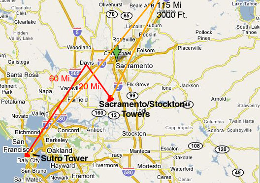

    The area between San Francisco and Sacramento California is known for thick ground fog in winter months. Observers in the Vacaville and Davis regions report poor reception for San Francisco at ~60 miles no matter how large an antenna is used. Meanwhile, I've been helping a friend that lives over 115 miles from the San Francisco transmitters but above the fog layer at 3000 ft. Once the directional antenna is pointed properly, he can get >50% for San Francisco channels year around. There would be no way to point that antenna without knowing the DTV channel number and setting it manually first. Channel scanning only sees the stations where your antenna is pointing.
    115 miles is really amazing! Being up on the mountain really helps.
    The following image shows a Sutro tower channel coverage in the Auburn area. The higher altitude spots on the western slopes actually get much better coverage than places lower down, even though Auburn is much further away than Roseville or Sacramento (purple or no-color is very weak coverage, blue is strong enough to be fetched with a rooftop antenna).
    It just goes to show that when it comes to OTA reception, height and the right location are your best friends.

    It helps to be west facing and 3000 ft up (>1000 ft above Stutro Tower). The blue you see in the upper right of the Auburn plot indicates increased elevation. Unfortunately I have a ridge blocking reception southwest from my home.
    Begs the question as to where you obtained those maps?
