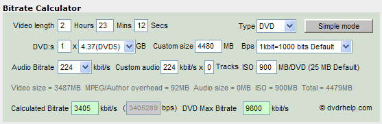

OK the first thing you need to do is determine the video bitrate you need to use. So you need to use a bitrate calculator. Here is a good one to use:Originally Posted by thisismyname07
https://www.videohelp.com/calc
After entering in the data it looks like this:
You will notice that I have put in the running time. For the audio I decided to "go around" the default. I like to put "0" for audio and instead use the actual file size of the audio file (or files). In this case the audio size is 772MB but we always want to leave some "overhead" for the DVD authoring stage. How much you leave is up to you and there is no real "correct" answer. In this case I've decided to make it 128MB so 772MB + 128MB is a total of 900MB which is where the 900MB comes from in the calculator.
You will notice that the bitrate is 3405kbps so I would use 3400kbps. For the MAX I like to use no more than 9000kbps.
So you are going to do a 2-pass VBR with an AVERAGE bitrate of 3400kbps and a MAXIMUM bitrate of 9000kbps.

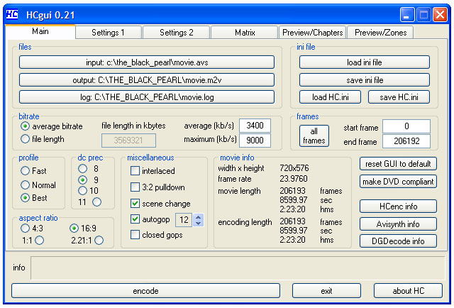

You want to encode at 23.976fps without applying 3:2 pulldown as we will be using DGPulldown to do the 23.976fps to 25fps conversion. Normally you would do 23.976fps with 3:2 pulldown IF you were making a regular progressive NTSC DVD Video.

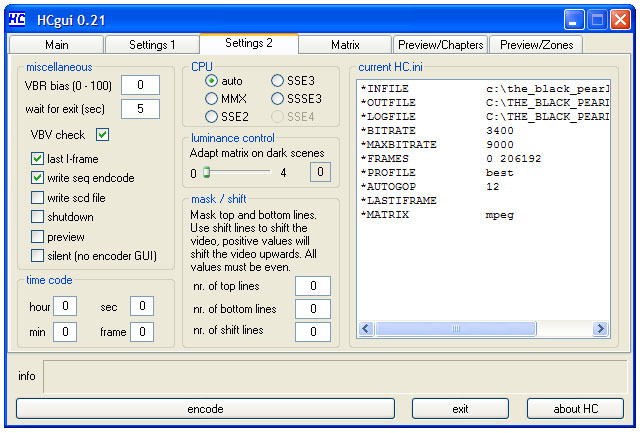

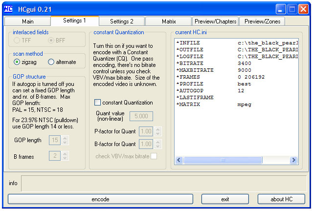

So fire up HCenc and set it up like this:
You only have to worry about the first three tabs. Change nothing on the other three tabs ... just use the defaults.
When done you will have a M2V file. This is a video only file.

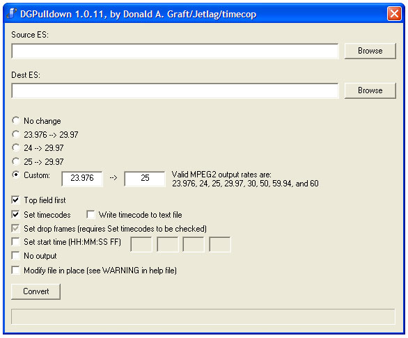

You load this into DGPulldown. You then select the CUSTOM option in DGPulldown and enter 23.976fps ---> 25fps
DGPulldown will create a whole new M2V file that is now PAL DVD Video compliant.

I was "lazy" before and didn't add an image of DGPulldown. Here is an image:Originally Posted by thisismyname07
You set it up just like that but of course you have to select your M2V file for 'SOURCE ES" and it will automatically fill in the "DEST ES" or destination for you. It's easy but I wanted to add an image for reference.
