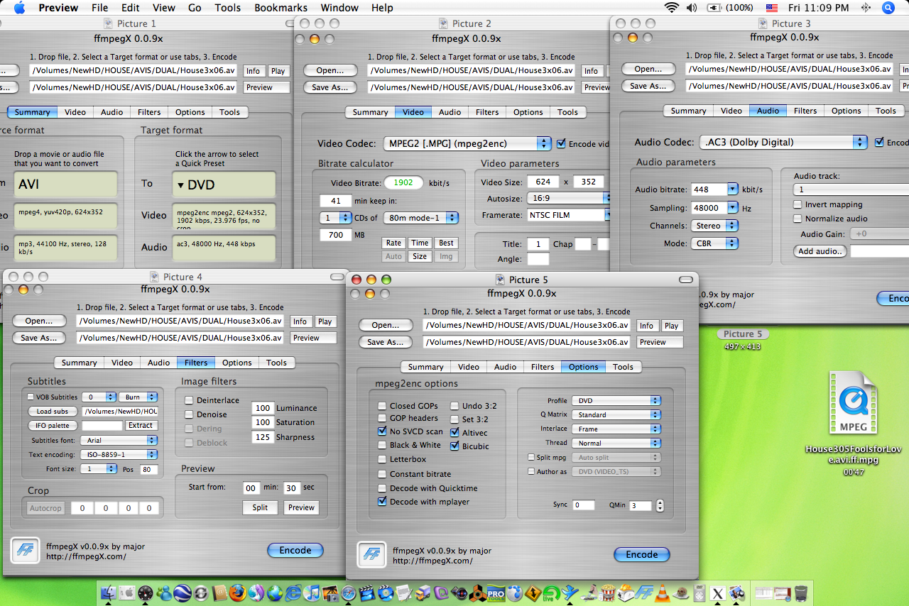

	Hello Again!
 -the subtitles sync problem appear right away (really little, like a second) but it get worse and worse as the movie plays...like...30 seconds?
 -the audio sync problem it doesnt appear in the preview, just after i actually encode the movie so I will have to encode it again to tell you.
 anyway, my settings are on the pict! hope it helps!
 thank you so much
 alina
	Hi Alina,
 Although you've chosen a non-DVD compliant resolution, I don't see any obvious cause of bad sync in what you've specified. However, here are some things to try:
 1) Try "decode with Quicktime" instead of mplayer (in your picture5). QT tends to do better keeping things in sync.
 2) Select a truly DVD-compliant resolution. Although that shouldn't make any difference as far as sync is concerned, sometimes bugs are provoked by odd things. In any case, playback compatibility improves if you choose a standard resolution. See https://www.videohelp.com/dvd.
 3) If you manage to get the subtitles and video in sync, but suffer from a persistent drift in audio sync, post back. I (or someone else) can walk you through some methods for audio resync (e.g., through the use of Audacity's "tempo change" feature)
 Good luck!
